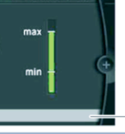

You're saying the green line on the diagram in iDrive is able to go above the top of the line? Seems like the top of the line is the top of the screen.
If it's able to show if overfilled, that's great! I didn't realize it can show same.
It was on many Idrive systems. I guess it's not on all newer ones I guess.

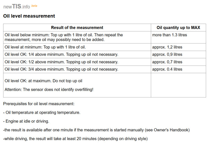

According to the TIS...the “sensor”doesn’t indicate overfilling...so I’m not sure if the iDrive display moves higher than the MAX line...so you should probably stop when the oil level indicator is at the MAX line:

With 'increased oil consumption', already running at less than max!
Hmm. :|
