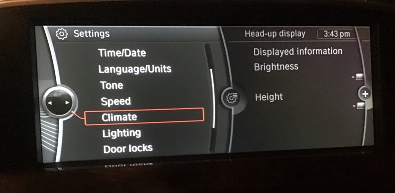

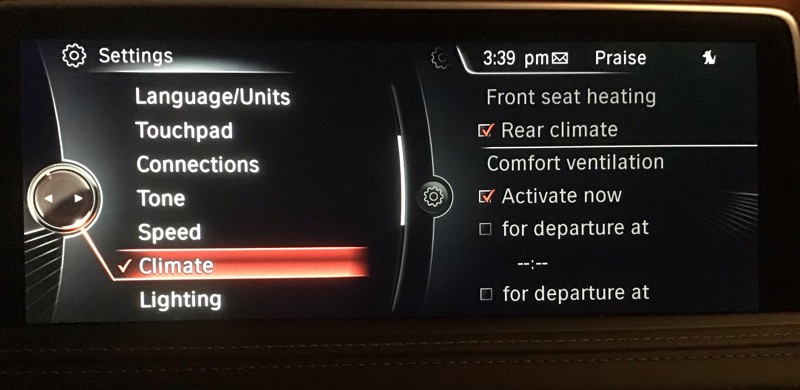

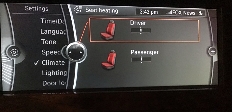

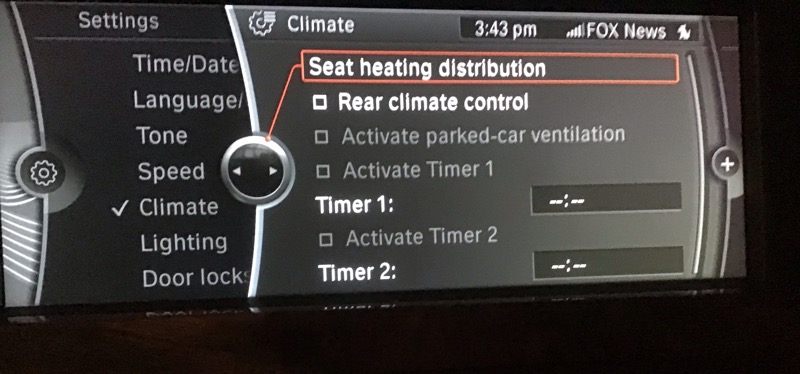

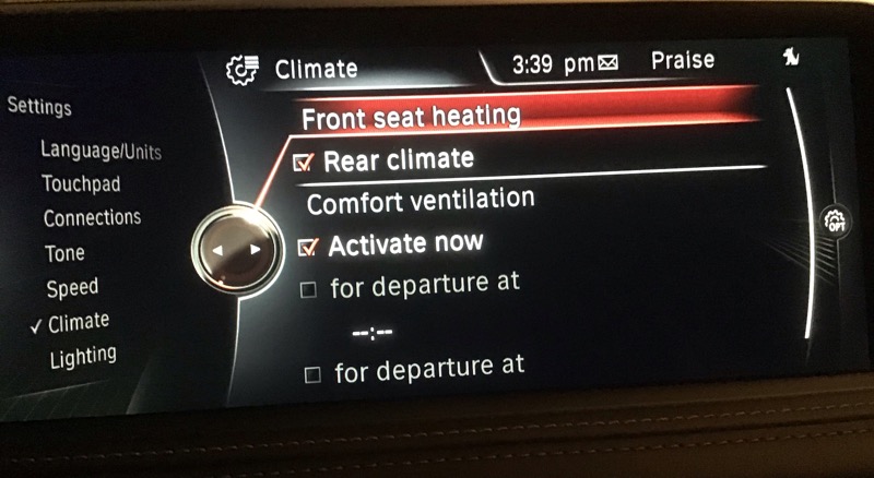

I changed my settings with the Bimmercode app so I don’t remember what each one was exactly...but I seem to remember them all being close to the middle of each range.
But regardless of coding parameters for the range of selected front seat heating...you have the ability in iDrive to adjust the front seat’s heat temp, too. Go to SETTINGS in iDrive, then scroll down to CLIMATE...you should see a selection for seat heating adjustment for the driver’s side and passenger’s side. I have this ability in both my 2013 f06 650ix GC (has CIC) and 2014 f15 X5 (has NBT).
EDIT: went out to the garage to snap a few pics to show where to go in iDrive to adjust the front seat heating. I will post pics from both vehicles since one is CIC (pics1, 2, & 3) and the other is NBT (pics 4, 5, & 6)...the wording is slightly different but the procedure is the same...and I’m sure this would be similar for the NBT ID4/ID5/ID6 iterations as well.

Many thanks all your support of this wonderful community, QSilver7.
I think those settings only refer to heat distribution - not to raise from the settings the car is coded to.
Meaning, if someone wants to use heated seats, but doesn't want both the back and bottom to heat, they can reduce one or the other.
