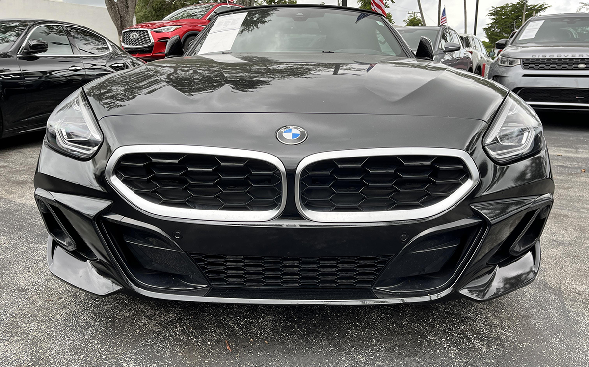

Mine included all surfaces, plastic or not. Though not the interior of the grill and similar part below it, because Jesus, who would?
(not my car)
Westside Guy10250.00
